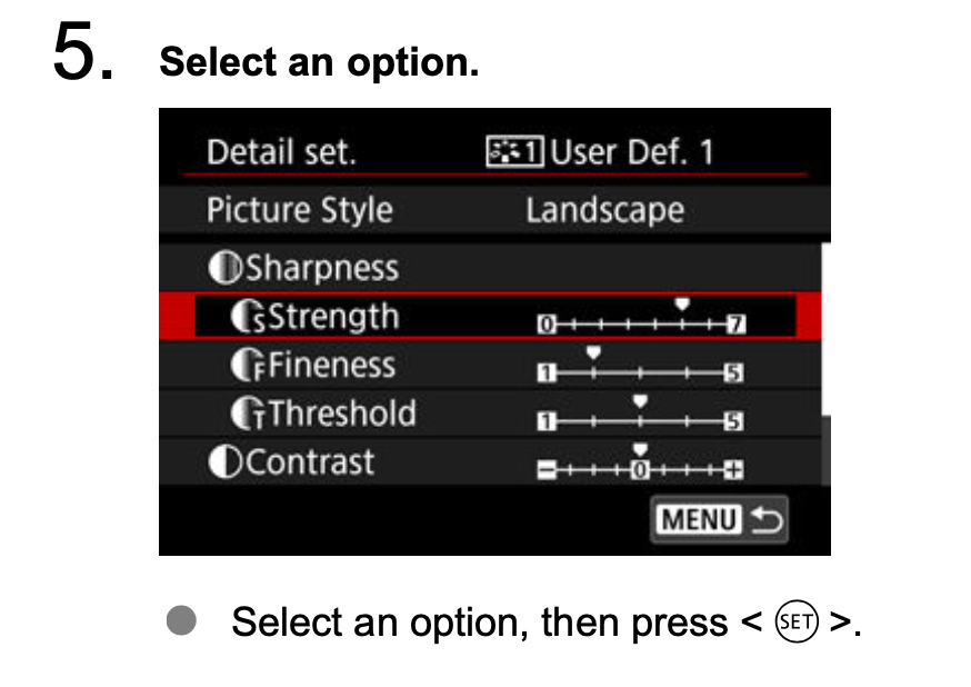

Honest, I've looked in both the printed manual and the pdf version, and I can't find the answer.
In the picture styles settings for the user defined styles, there is a setting for "sharpness" but it doesn't allow any changes. Am I missing something, and if it's not to be modified then why even put it in the settings menu?

As kvbarkley stated, you must select one of the "Sharpness" parameters.
Then Press SET to change the selected parameter.
Then Press SET again to store the new value.
"The attached image is an example (taken from an online tutorial) of the detail set screen with the sharpness parameter simply not adjustable."
Sometimes it's better to read the step-by-step directions in the manual rather than a possibly simplified "online tutorial" 😋

The attached image is an example (taken from an online tutorial) of the detail set screen with the sharpness parameter simply not adjustable. It's like that in any of the picture styles selections, the Portrait one was just the one I grabbed to illustrate my point.

Note the indent:
I think that Strength, Fineness and Threshold are all components of Sharpness. It seems to me that rather than having *no* sharpness control, you have an embarrassment of riches!
10-26-2022 03:55 PM
Hmmm, I never considered that. Interesting.
Thanks!
