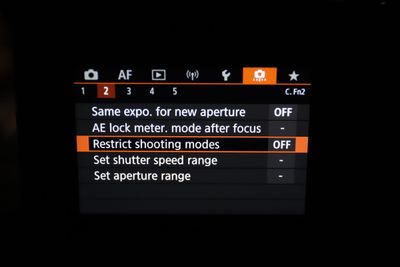

01-15-2023 01:07 AM
I found that it's in the settings called restrict shooting modes. I turned that off and it fixed this problem. I included a photo of the menu but it's under the custom functions tab, #2, third option down.
