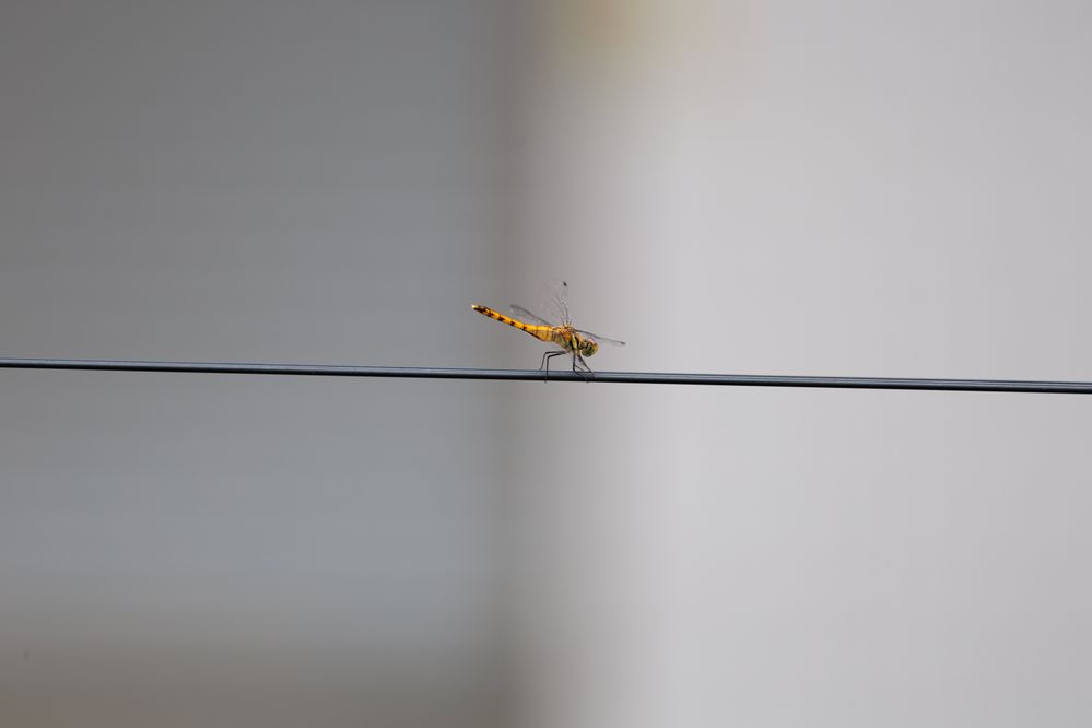

Hello. I noticed this spot on the bottom left corner won't go away after several swab cleaning. I have a feeling this spot has been there since I purchased the body back in Feb and have not noticed since it is in the corner of frame.
I have cleaned the lens with camera wipes and the camera sensor using 24mm swab with cleaner a few times. I use the swab one time only and have done it 3 times. Should I bring it in to Canon to have a look?

Greetings ,
Maybe it's because I'm on my mobile device but I'm not seeing a.dot. Can you put an arrow or a little circle around it for us please.
07-20-2025 06:40 AM
Ok. I cannot edited the post anymore. Here it is again.
07-20-2025 08:24 AM
Thanks. I saw that but wasn't sure If that was what you were referring to. Do you have another lens to test with? That should confirm with certainty if the issue is with the camera or a lens.

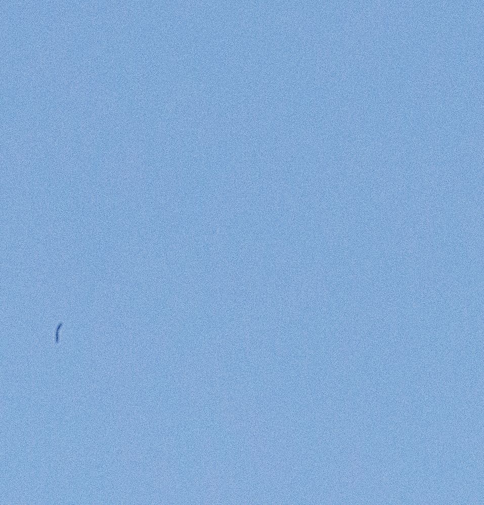

Stop the lens down to f/16 and take a shot of clear sky. If it is a sensor spot they usually become more distinct at small apertures (due to light rays becoming more parallel).
07-20-2025 10:44 AM
It’s definitely from the body. I have 2 lenses & it appears on both. Also, I can see it in the digital viewfinder.
07-20-2025 11:30 AM
Greetings,
@John made an excellent suggestion. However, now that you've tested with two lenses, cleaned the sensor still see the same anomaly, I'd want to have Canon look at it.
Please create or log in or into your MyCanon account. Register the camera and initiate a inspection/repair request.
MyCanon https://share.google/bzON2qz8topPHg4Uc
If you're shipping your camera in, make sure you package it well and insure it.
07-20-2025 08:06 PM - edited 07-20-2025 08:19 PM
Edit: I looked more carefully under a bright white light and I do see something on the top corner. Should I do the swab again or take it in to have Canon inspect it?
Here is a shot at f40. Looks like a grim of some sort. I tried to visually spot it with the naked eye, but can't see it. Since the anomaly is on the bottom left of the photo, I assume it should be located on the top left corner when looking directly at the sensor??
07-20-2025 08:13 PM
Looks like there is a new particle on sensor. They are very easy to remove in post, so if it was me I wouldn’t be trying multiple sensor cleanings by touching the sensor. Could do more harm than good. If a rocket blower can’t remove it I would leave it.
