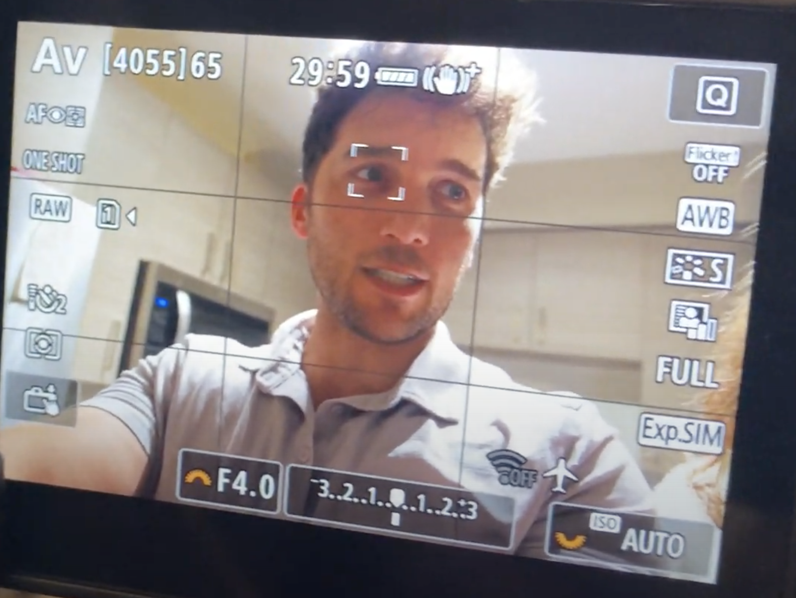

My fiance and I bought a new R6 partially for the flippy screen so we can take selfies together. It's easiest to hold the camera by the lens when taking a selfie but then you can't click the shutter button. I like the 2 second timer option, but it 1)focuses  2)counts down 3) shoots. The order needs to be 1) count down 2)focus 3)shoot.  See video link below for visual description:

I think you are the problem.  According to the video, the camera is "One Shot AF" mode.  See the upper left corner.
Using "One Shot AF" means AF tracking is disabled.  I think Nikon calls it "AF-S" mdoe.  You want to use "Ai Servo" with a Canon body, which is equivalent to Nikon's "AF-C" mode.

"I think you are the problem." Harsh, dude. I tried with in Servo mode as well. no difference
