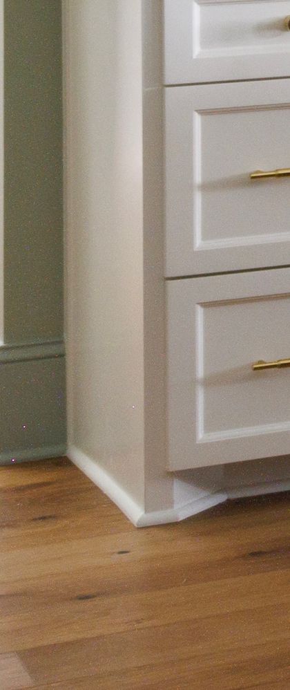

Hello,
I am an interior Design photographer and I just changed from the Mark IV to the R5. There is so much noise and some colorful dots all over my photos. AlexandraKillion-Guinea-100.jpg

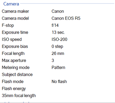

I pulled what data I could from your jpg photo.  Are you shooting in RAW or .JPG typically?
What lens are you shooting with?  Properties show 35mm and 26mm?
f14, 13 sec exposure.  What kind of lighting was available?
In order for us to help, can you please post a RAW image of a problem photo.  Use OneDrive, Dropbox, Google Drive etc.  This will allow us to determine what the issue might be, exposure, camera settings, etc.  We should be able to get everything from a RAW photo.

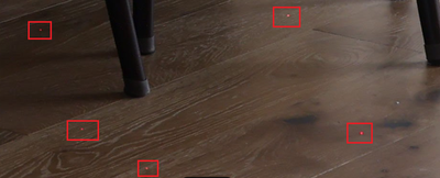

You will get dots at long shutter speed. Normally your raw converter will handle them.
In your case I would just take a dark frame. You enable Long Exposure Noise Reduction for that.

I see a bunch of hot pixels.  These are a by-product of a 13 sec exposure.  Reduce the shutter speed. Try f8 or f11 to keep an acceptable DOF.  Use a tripod if you aren't steady.  If you need to bump ISO don't exceed 800.  You could also consider some off camera lighting.
Try shooting in Fv, Tv or Av to control one or more legs of exposure.  You can shoot in "M" if you like, but not with a 13 sec, ISO 200, f14 indoors without better lighting.

thank you for your response. I do use a tripod and use flash. This is just my base layer, and it just never happened with my mark iv. First time I have seen hot spots like this.
aherrmannj
I just uploaded a couple more that are at faster shutter speed.
