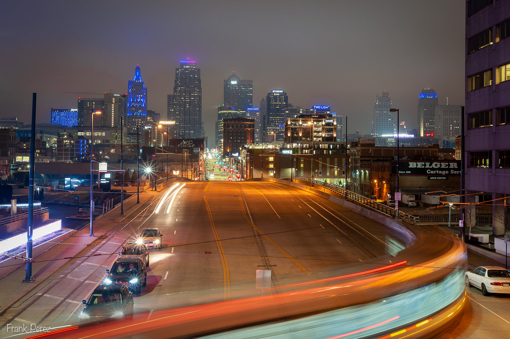

All camera equipment has limitations. You may have exceeded what can be done with yours. Without seeing exactly what you are shooting no one can give you exact settings.
As to learning the exposure triangle, which is a good idea, it can become useless in extreme conditions like nighttime shots. This is where trial and error or bracketing becomes useful. This is where you shoot the same scene with multiple settings to determine which one will satisfy the "exposure triangle" so to speak. Using a tripod will be helpful here.
Here is a sample a good friend of mine shot using a tripod and a long exposure. Is the what you are after?
