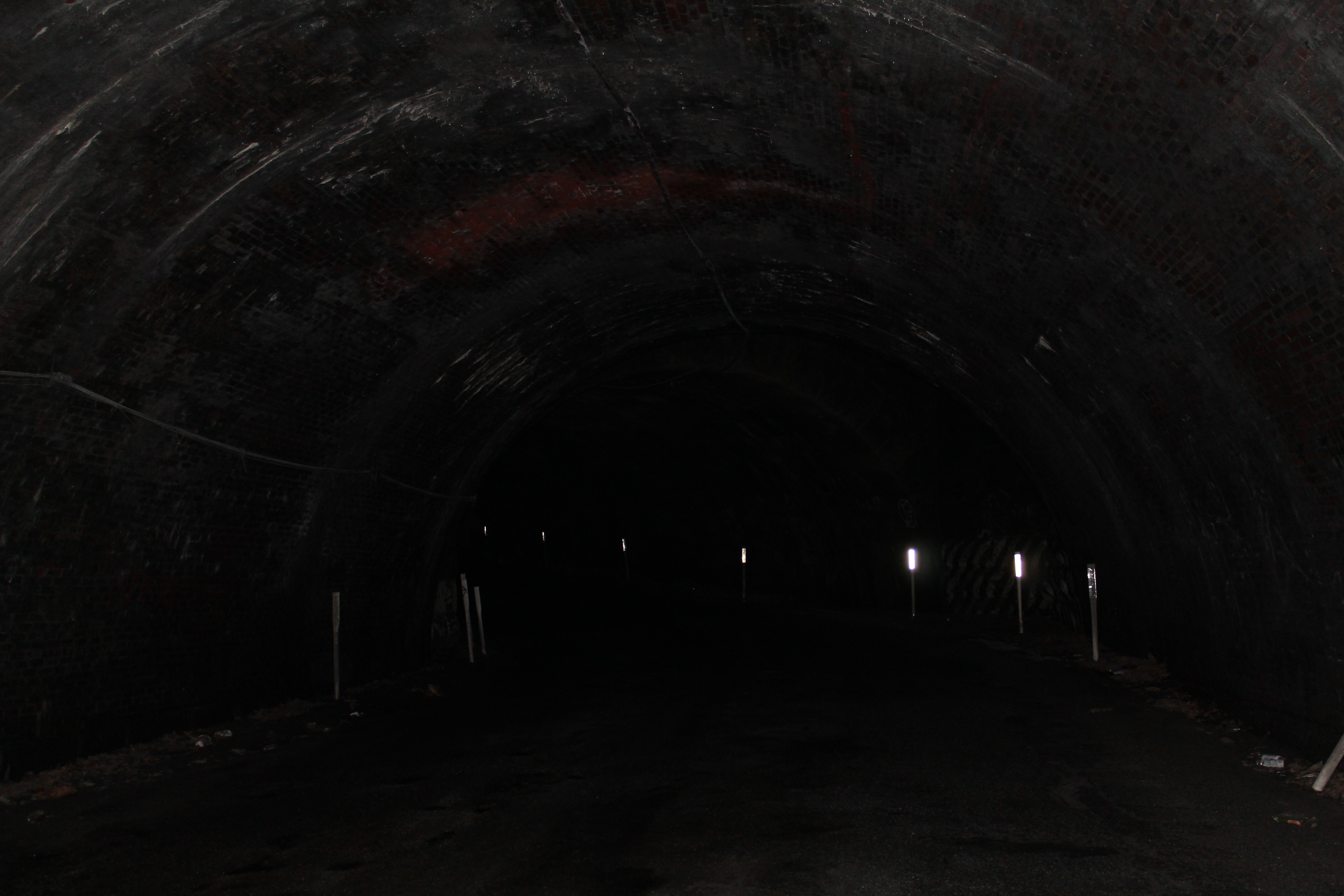

Hi.  Thanks for the reply.  I am looking to photograph things that don't move like tunnels, abandoned ruins, buildings, etc. some at night and while in haunted tunnels this past weekend I was having difficulty trying to get the shot just right like the one below.  Again, I have a Canon EOS Rebel T100.   IMG_0704.JPG
It is unclear, is the posted shot a "good" one or a "bad" one.
In any case, have you tried to adjust the exposure compensation?
"It is unclear, is the posted shot a "good" one or a "bad" one."
I am assuming it is not what is wanted. It appears like it is a very dark situation.  My guess is you need a tripod and a long exposure.  Perhaps several seconds. I would not use exposure comp and rather set the exposure myself.
Here is what you should do.  Bracket, bracket and bracket.  Set it up on a tripod and try several different shutter speeds.  You can do either Tv mode or full manual.  Keep in mind a doubling of the SS is one stop.  So, if you set a 2 second exposure as a beginning and it is still too dark, try 4 seconds and than 8 seconds, 16, etc. Each time is one stop more light.
Again remember all photography gear has its limitation.  You may have exceeded what is possible with the gear you currently have.

" You can do either Tv mode or full manual. "
I would be more inclined to use Av mode.  Dial in ISO 100, and half press the Shutter Button to check the calculated Shutter Speed is doable, and you do not need to raise the ISO.

ebiggs1
I want her to bracket and Tv makes that very simple. Or manual whichever.
As with all photography there’s many ways to do the same thing. In this case Tv is best.
