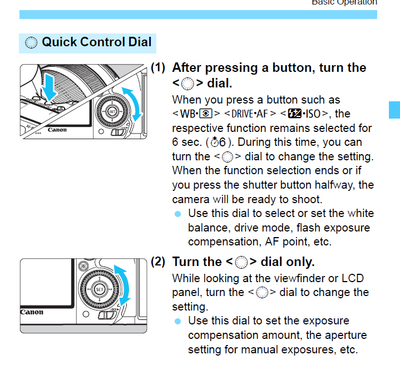

In the case of the 7DMkII, as I am sure you are aware, that function is assigned to the rear control wheel, and is accessible when you have pressed the focusing/exposure button.

“ In the case of the 7DMkII, as I am sure you are aware, that function is assigned to the rear control wheel, and is accessible when you have pressed the focusing/exposure button. “
Shooting in M mode with ISO set to Auto.  I use the main wheel for Tv, the rear dial wheel for Av, and the [SET] button plus the main wheel for Exposure Compensation.  I think of it as Ev mode.

Bill, I'm not really commenting on BBF or not - I'm commenting that there is such a thing as an EV dial and that by default its function is assigned to the rear dial - that's all...  To me, is a convenient and consistent way of overriding the exposure chosen by the camera.  As to the rest, I am rather bemused...

I’m just saying the default behavior of the rear dial in M mode is Av control, not exposure compensation.  That’s all.

I agree that the rear dial is Aperture control in manual mode, but in other modes, such as Av mode itself once the shutter button is half pressed one can turn that dial to enact exposure compensation, i.e. it becomes a EV dial for that purpose.  I really DON'T want to get into a debate about the merits of BBF and conventional focus.  Yours works for you and mine works for me, which is excellent!
To belabour a point that I was trying to make. I was simply trying to explain that there is such a thing as an EV dial and where that function is located, in default configuration on the camera body. From P57 of the 7DMkII Advanced User Guide: ref point 2.
cheers, TREVOR
