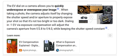

"Who said anything about EV (electronic viewfinder I assume)?
Actually, your presumption is incorrect. If you Google the question "what is an EV dial" you get:
The term is in pretty standard use across all camera makers.
