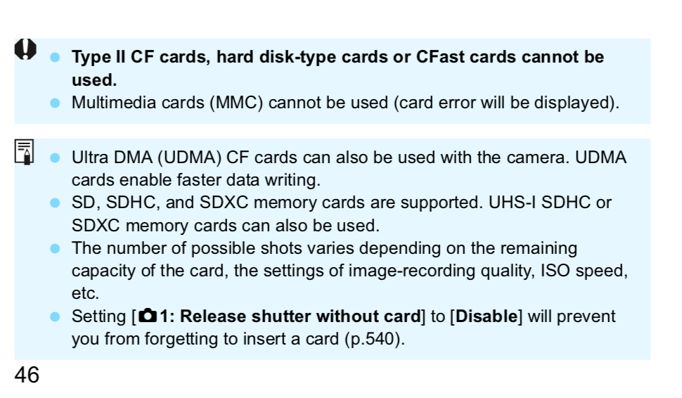

I do not know if you are describing a CF card, an SD card, or a micro-SD card.  Plus, there are variations on the performance of memory card.
From the 5D4 Instruction Manual.
