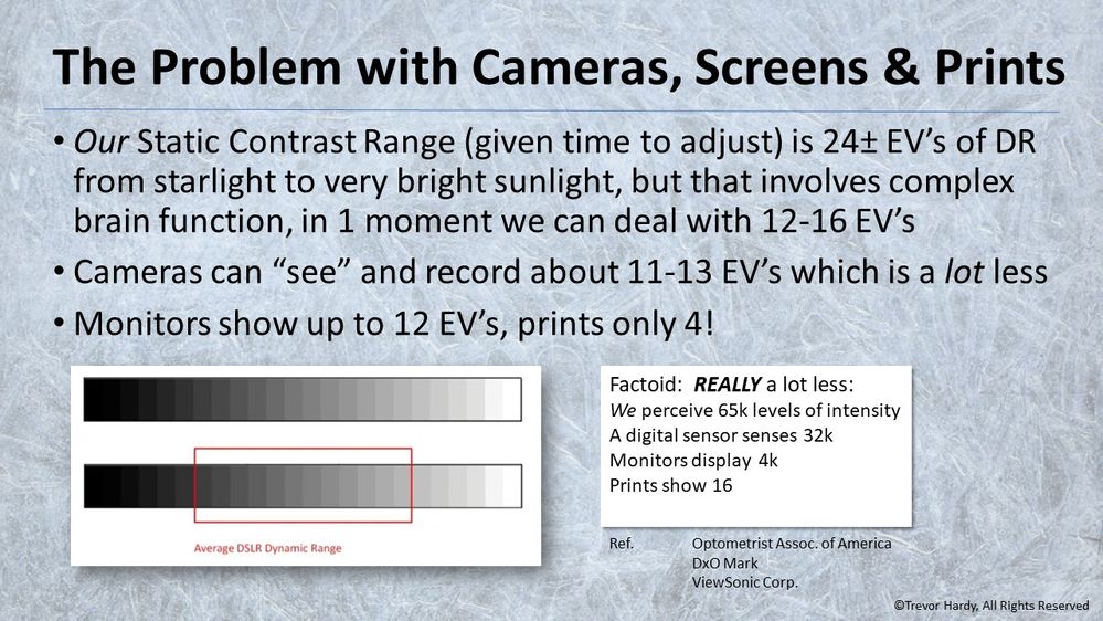

Sunny days are a bit of a trap.  It might seem like a good idea to photograph people in bright sunshine, but the dynamic range - i.e. the difference between bright and dark areas of your image, will be too great for the camera to capture.  Stops or EV's (Exposure Values), are each either a doubling of halving of light intensity, they are the common currency of exposure and appear in Shutter Speeds, Aperture and ISO values.  While we can see between 20 and 24 Stops (human sight varies quite considerably),  most cameras can barely deal with more than 13.
