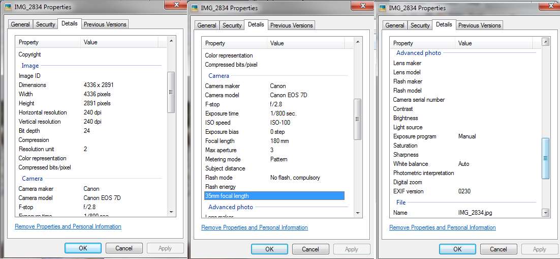

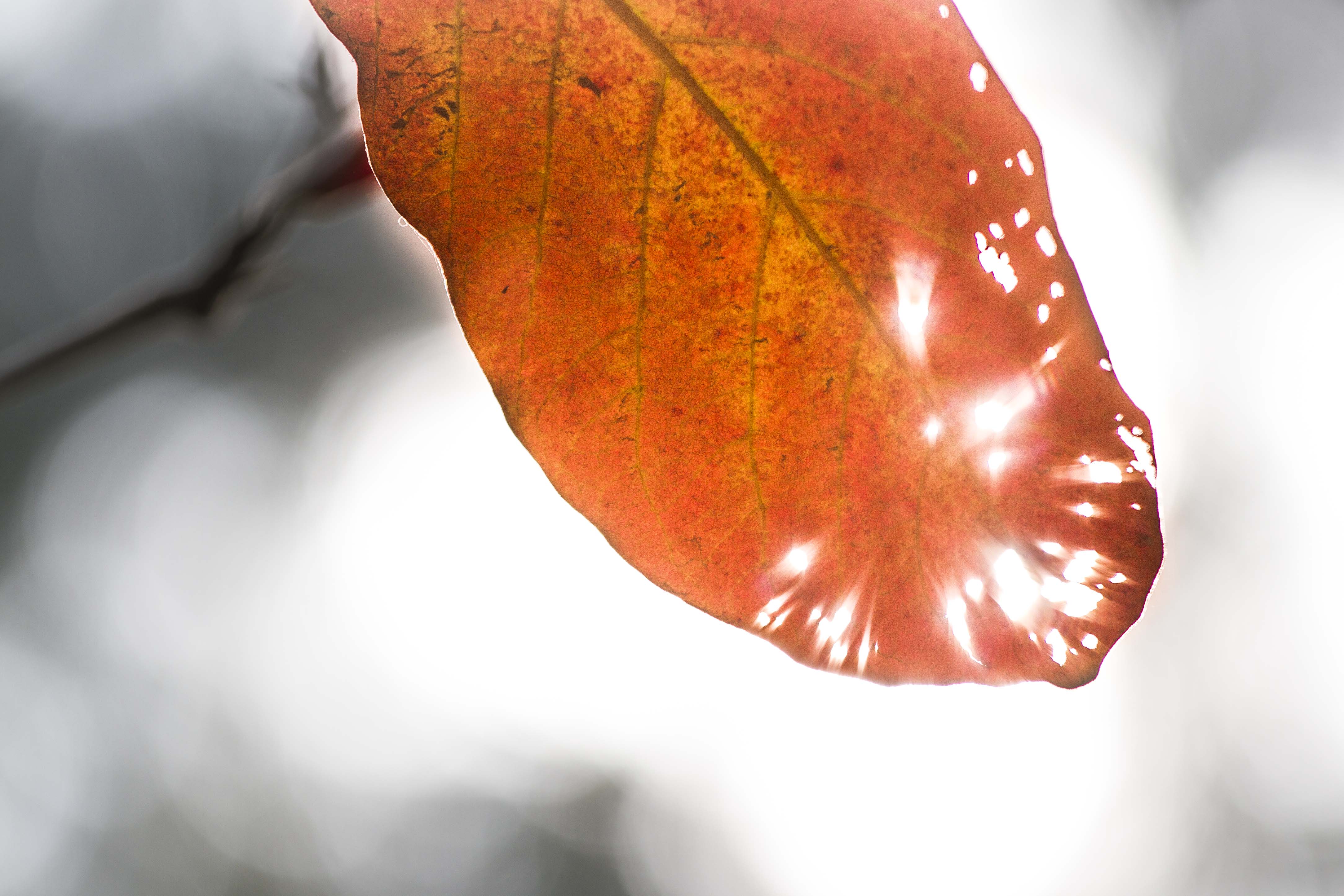

03-31-2014 01:30 PM
03-31-2014 04:15 PM
You used Evaluative (Pattern) metering, which is Canon’s ‘intelligent’ pattern-metering mode. This system works by dividing the framed scene into a series of zones, although these aren’t visible in the camera’s viewfinder. The amount of light is analysed in each of these zones, and the camera calculates an exposure setting that will produce a balanced result. Evaluative essentially applies its own exposure compensation; if it detects that the outside zones are considerably brighter then the middle zones, it might perceive this as a backlit subject and increase the exposure. Which appears that yours has done this.
