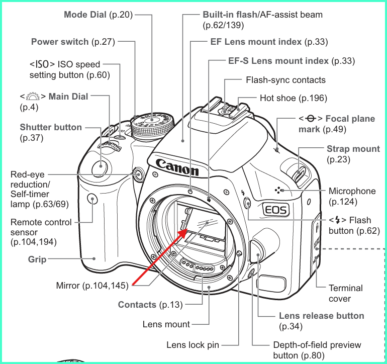

I have a Canon model # DS126231. The mirror inside has been tampered with and when I go to take a picture the display is black. Do anyone know how to adjust the mirror or reset the camera.

The mirror inside your camera is not adjustable. Are you sure that's what you mean?
If a child put their finger in the mirror box it is very unlikely that a reset will solve the problem.
