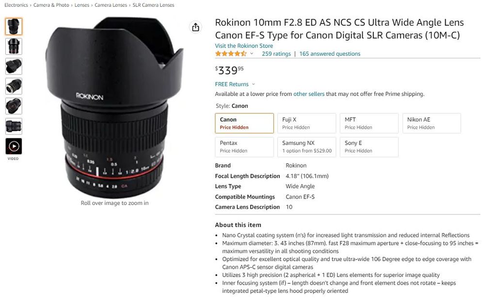

I bought this Rokinon 10mm F2.8 lens but the shutter won't do anything?
I'm in Manual mode and the front switch is also on Manual, am I missing any settings or I just can't use EF manual lens on R7? Anyone ever used any manual lens with EF adapter on R7?
[Commercial link removed per forum guidelines and replaced with screenshot to facilitate discussion.]
