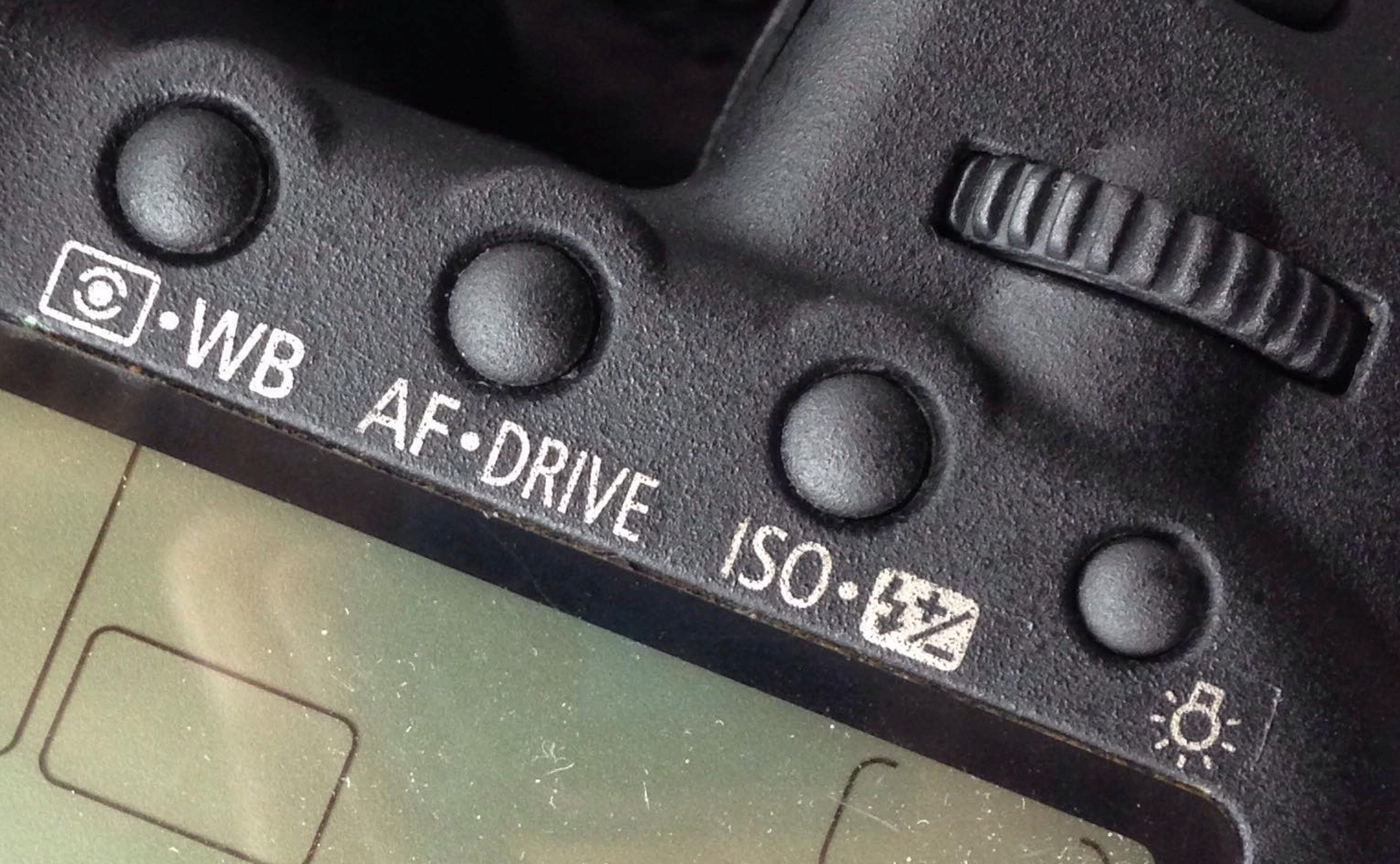

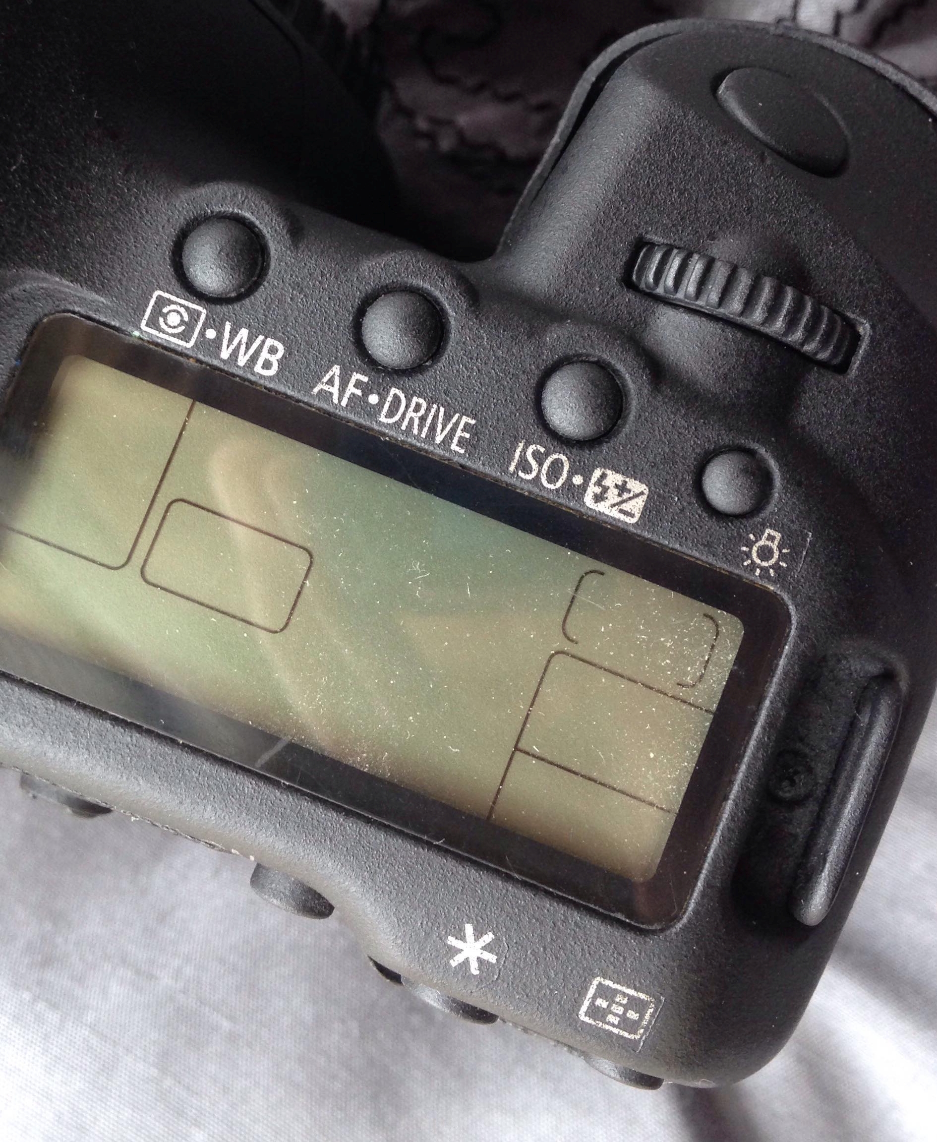

Hello guys, so I just bought the Canon 5D of my friend and I noticed that the buttons look different from other 5D. it was matte not glossy and all buttons are like that. Please see attached pictures.
thank you I cant sleep thinking about it cause its my first full frame camera..

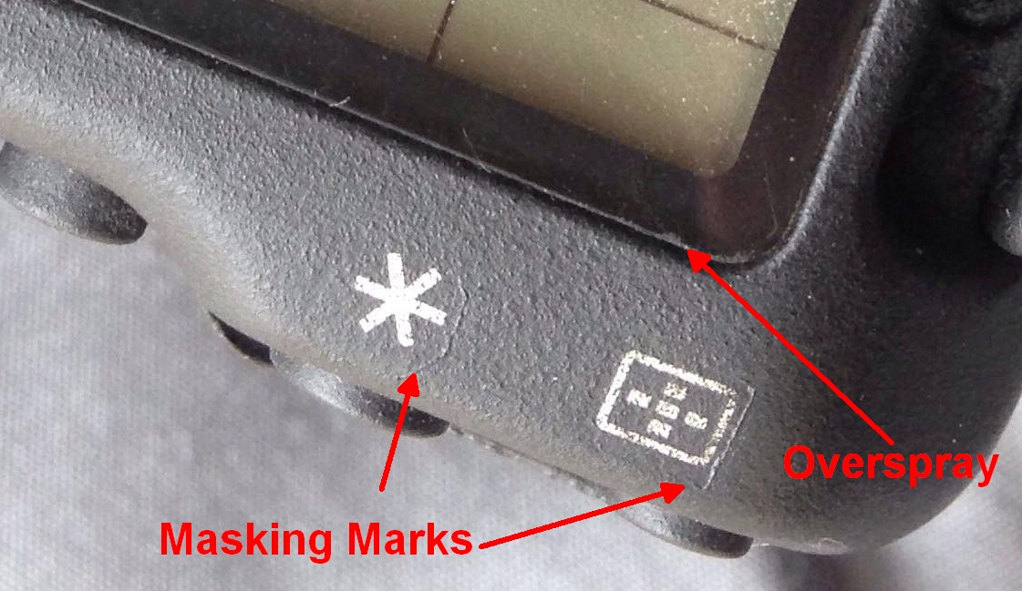

It sure doesn't look right. The buttons should be smooth and shiny. It looks to me like someone has painted over the entire body.
If you look closely, it looks like you can see residue where they masked off the lettering and symbols. There is also some overspray visible on the top LCD.

I would say that is a definitely a genuine 5D but one that has seen a lot of use by looking at the rubber on the handgrip.
Someone has done a pretty amazing respray job getting such a good match to the original finish, just a shame that they sprayed over the buttons which I would imagine could make them a bit stiff to use. I realise that you have now bought this but I think I would definitely have avoided this one.
