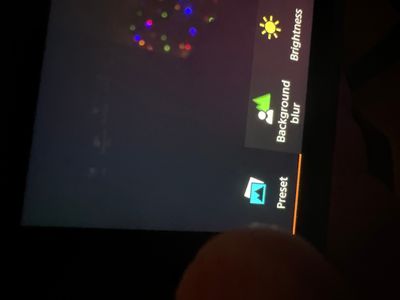

 I’m on my user1 settings, it’s on vivid color option, when I turn my canon EOS R8 off the user1 settings needs to be manually activated again, it does not stay on user1. Camera when turned off goes back to the original settings, does not stay on user1.

VIVID is a Creative Assist processing option. It cannot be set as a default.
Canon : Product Manual : EOS R8 : Creative Assist (start.canon)
