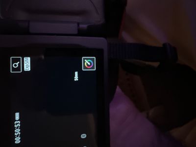

How do I keep my color settings on default on my Canon EOS R8 without having to set them every time I turn on & off my camera?
when you turn offf the R8 it goes back to the original camera default color settings and you have to again click on your user 1 settings every time you turn on the camera.

I’m on my user1 settings, it’s on vivid color option, when I turn my canon EOS R8 off the user1 settings needs to be manually activated again, it does not stay on user1. Camera when turned off goes back to the original settings, does not stay on user1.
