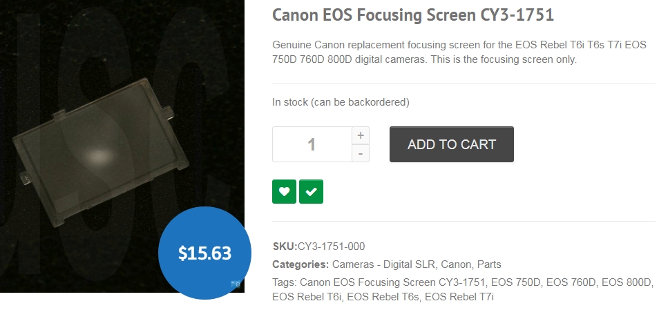

Honestly I was pretty sure it was called a focusing screen, but I may be wrong. It was just the common term while googling. I’m talking about the removable (I’m assuming it’s plastic) piece that is towards the top of the camera. I’m adding a photo (not mine, I took it from the canon website) mine looks like this, but I wasn’t sure if all of the cameras used the same piece or if they are fit by model. I’ve seen a few different types when looking them up so I wasn’t sure if they did different things or were for different bodies. Thank you!

The Canon part number is CY3-1751-000
It appears as thought this same part number is used for the 750D/T6i, 760D/T6s, 800D/T7i and 77D.
Since you have already proven you have the skill needed to remove and replace this part, just make sure you order the correct one and you should be good to go...
