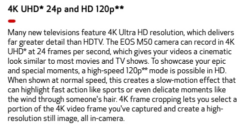

First. let me go on record saying that the M50 manuals - both of them - suck. Suck Big Time. So I can't even exhort you to RTFM.
Second, check out this from the website for the M50:
Looks like the slow motion thing is a feature, not a bug.
