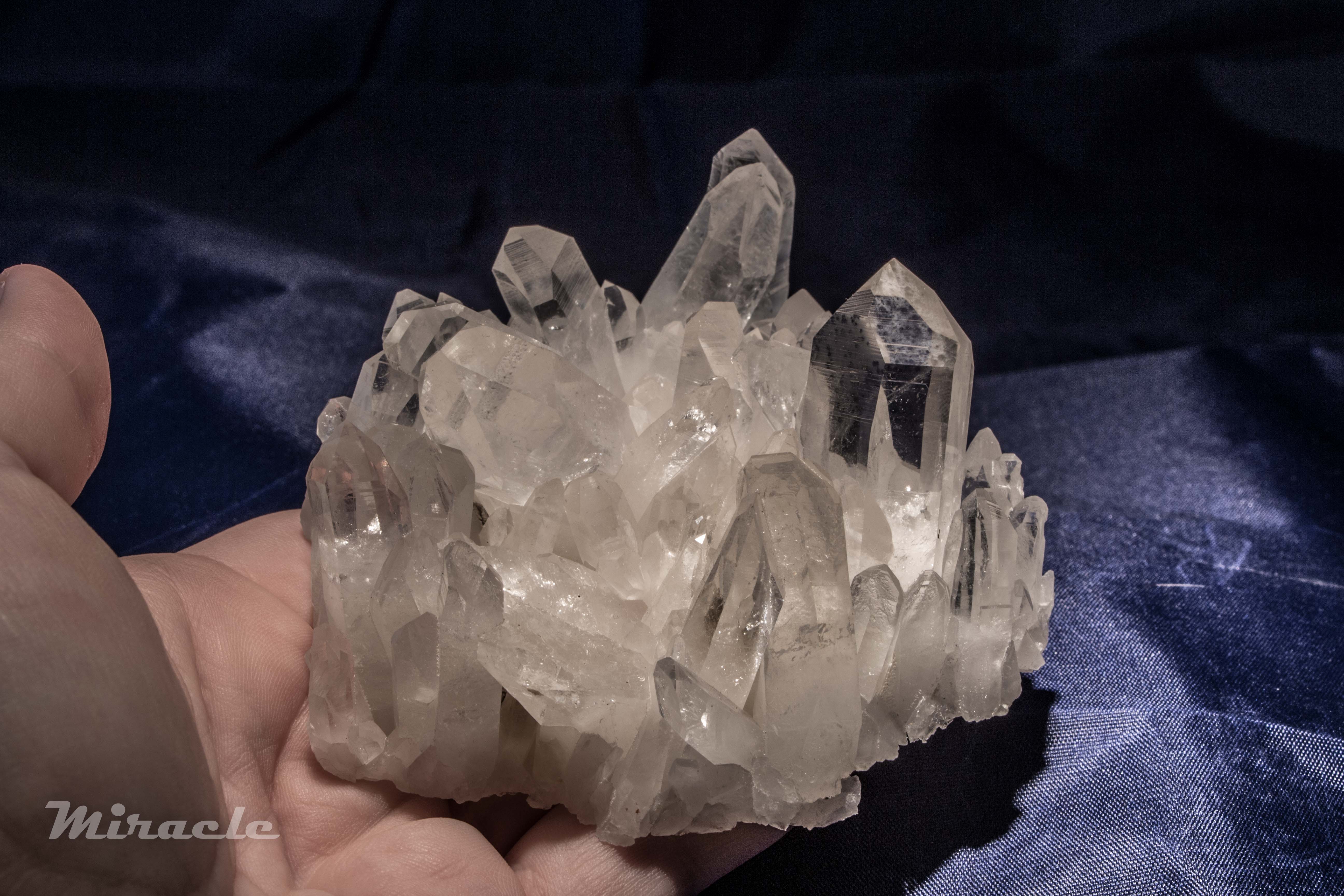

So, I do not normally shoot intentional still life.
Today I am attempting to shoot a collection of crystal clusters I mined in Arkansas.
I have a light box set up, all the proper staging - but I am having issues with shooting the clusters.
I have the full set of focus points active, but when I go in to shoot no matter what I do the camera chooses to focus on one or two points to one side of the cluster leaving the rest of the cluster fuzzy. No amount of re-focusing or moving seems to help.
I need every focus point active 100% of the time (unless I choose to change it).
Is there a way to force every single focus point to be active 100% of the time... a setting I am missing??
There is probably a very obvious answer to this, but I am having a very blonde morning.
Many thanks in advance.

Thank you!
Simply changing the aperature did the trick. I got the focus I was looking for.
Now to figure out the best way to light a crystal, lol! The points are fine, but the interior of the clusters seem to get washed out.
So much to learn! Makes life interesting 🙂

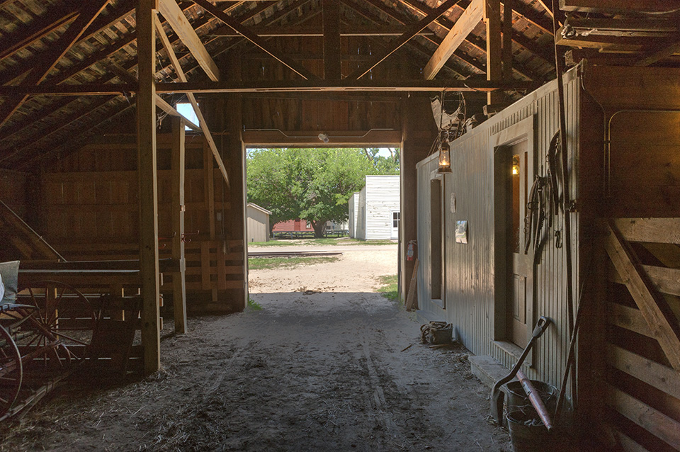

And the correct answer is shoot in RAW, not jpg. Use a good post editor (Photoshop is the best). It may be necessary to stack several exposures. A correct one for each part. You can even make sharp focus for each one and not rely on DOF so much.
All cameras have a limit, focus and/or exposure, is just part of it. Post editing removes some (most) of the limits.

I always shoot raw, but have not tried stacking exposures. I'll give that a try as soon as I get time to really play with it!

@MiracleB wrote:Thank you!
Since the crystal mass is basically translucent, I might start by trying to light it from behind with a small LED flashlight.
One of the others suggested exposure stacking. I think that's overkill at this stage of the game. Treat it as a last resort if you can't manage to get the effect you want by a simpler method.
12-31-2015 04:35 PM
"Treat it as a last resort if you can't manage to get the effect you want by a simpler method."
Hmmm, three bracketed exposures with the camera which is done automatically. Import into Lightroom. Select and make two mouse clicks. Darn, how I wish it were more simple. Oh, the drudgery.
12-31-2015 04:52 PM
MiracleB,
This shot below is quite impossible without stacking. It is not only possible to get it though but it is quite easy to do. You can expose for either the barn or the outside. You can not get both in one shot. Your situation is not this drastic so it will be quite easy to get everything in focus and exposed correctly.
Sample of a stacked photo.
This is not even new. It was done a day or two after photography was invented. Around 150 years ago! ![]()
