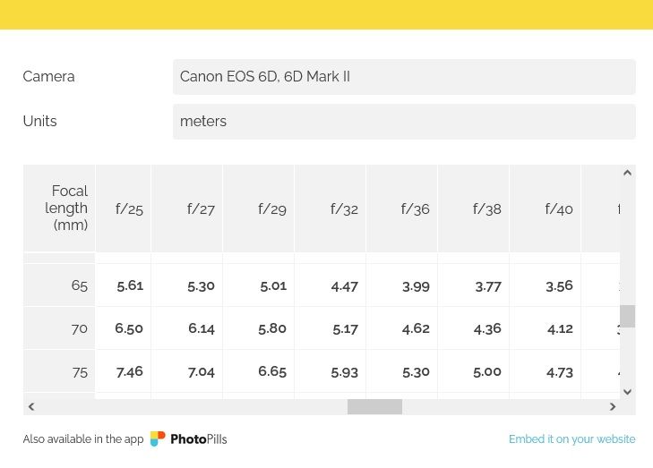

I don't know, at 70mm, f/32 the hyperfocal distance is 5.2m, so everything from 2.6 meters on would be in focus.
If you do use bracketing, make sure to use a large increment.
