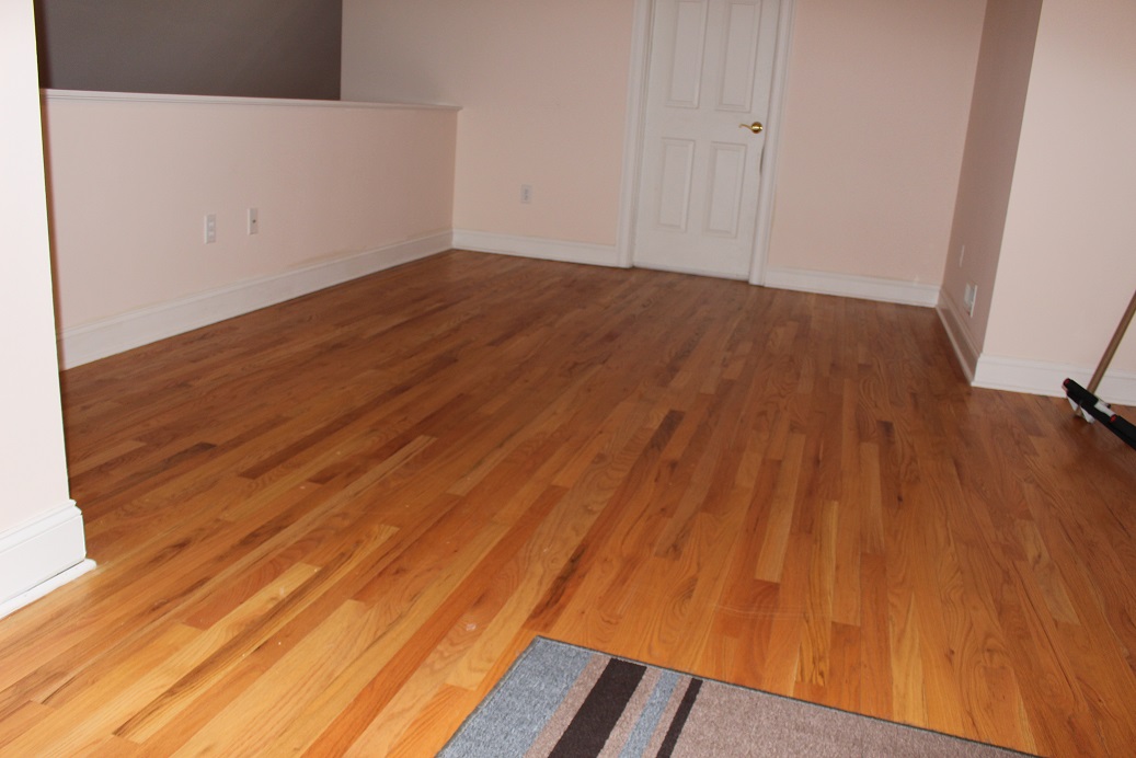

My camera now also takes really grainy pics, and yellow pics no matter what I do with lighting. I had a friend bring his nikon and that thing does amazing. Seriously amazing. Mine is absolutely horrid. I am not comparing canon vs nikon. What I am saying is that there is obviously something very wrong with my machine.

01-06-2016 07:44 PM
OK. That's the European version of the T5i that I have. If indoor photo without flash is properly exposed but yellowish that isn't abnormal. Depending on lighting the auto white balance can't always correct coloration.
If if you go to Auto flash will pop up and you should get less tinting.
