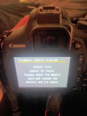

Firmware update error, file cannot be found Help me plz!!!!

What model of Canon Camera do you have?
Here is a instruction page from Canon on how to update your firmware.
https://support.usa.canon.com/kb/s/article/ART180770

My initial thought is that the user did not unpack or unzip the download and copy the .FIR file to the memory card, but we'll see.

Or, he or she did not put the .FIR file in the root directory and possibly unpacked the files into the DCIM folder.

Try these and let us know the results.
Firmware updates are cumulative so you do not have to update sequentially. What does that mean to you, updates can go straight from v1 > v5, there is no reason to make the updates in between releases if you missed one/some .

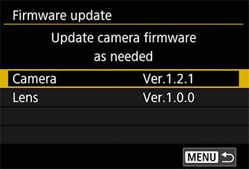

  • Turn the camera on, go to the menu, select the wrench menu, select firmware update.
  • At this point you will need to use the quick control dial for all your selections during the update process. The quick control dial in located on the back of your camera, the placement and appearance may be different depending on the R series body you own. Use it to move menu from the preselected prompt highlighted which is Cancel to the prompt OK. Once your selection is complete use the Set button initiate the selection. Do not press any buttons or attempt to operate the camera until the firmware update is complete. The touch screen and other dials do not work during a firmware update.
  • Follow the prompts in the firmware update menu selection (Body/Lens).
If you follow the procedures exactly and the update fails you may want to delete the original download from your computer, this includes the file in your download folder. Reformat the card used for the firmware update.  Download a fresh file from Canon and attempt the process again with a clean file. Files can become corrupt during the download or the unzipping process.
