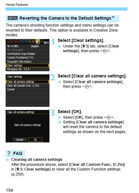

1) Follow the instructions that kvbarkley sent you on "Reverting the Camera to the Default Settings". It very important.

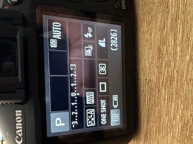

2) Make sure the lens is set to "AF" and "Stabilizer On"

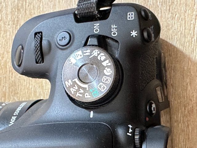

3) Set the dial on the top right hand side of the camera to "P"
4) Go outside and practice taking picutres of anything. Start with objects that don't move or move slowly, people, pets, inanimate objects, everything. The more bright the light is (sunlight preferably), the better. But but try everything. Experiment and have fun. Review your results. The camera is smart and will figure out exposure and probably focus on the closest object to the camera. That's OK, just be aware of it.

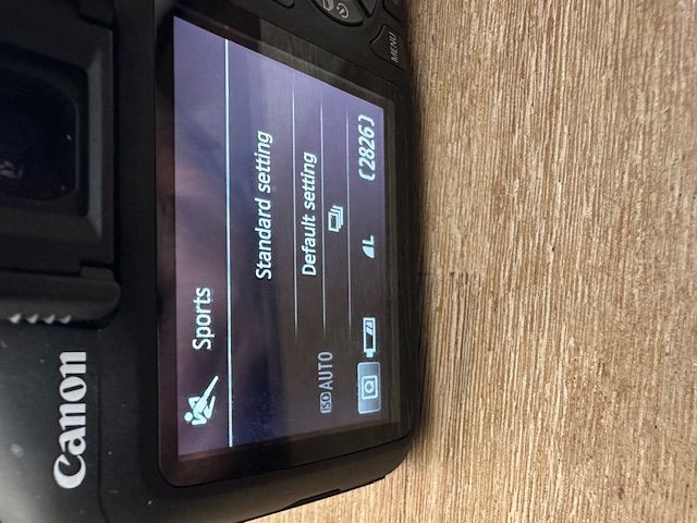

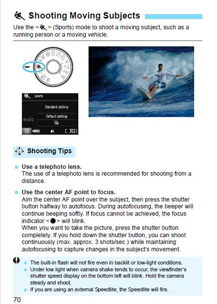

5) Now try shooting moving objects in "Sports" mode (cars driving down the street, people walking, pets meandering around, people on bicycles, skateboards, scooters, etc.) Follow the instructions for this mode that can be found on page 70 of the manual.
