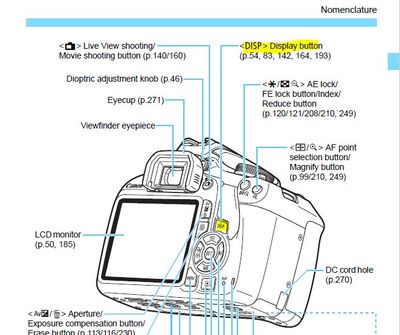

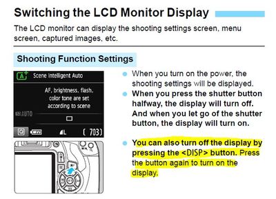

kvbarkley
Try hitting the "info" or "Disp" button.
Or sometimes the eye cup slips and covers the LCD eye sensor.

Okay, this is freaky.  I switched the camera on & pressed the display button, but nothing happened.  Then, I tried again, and it worked.  It went black again, though.  So, I assume it is timing out.  Perhaps with the reset, something changed.  I never adjusted that previously and the monitor had always remained up with the camera being on.
kvbarkley
Sounds like a flaky Disp button to me.
And again, make sure the eyecup is seated properly.
