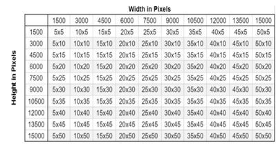

This is what I'm looking at from my marketing company.

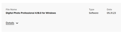

In addition to Bob's detailed explanation 😃, ensure you are shooting in RAW format.  This allows the most creative flexibility.  You can use Canon's free Digital Photo Professional to edit, correct/enhance your images, and convert them to an easy to print, post format.
Canon Support for EOS Rebel T7 | Canon U.S.A., Inc.
Its available for Windows or Mac OS

rs-eos
The marketing site would need to at least provide one other value.  Just providing a 300 DPI value is not enough information.  e.g. that value implies you could submit a 300 x 300 pixel image that would print out as 1-inch square.
The site should additionally be providing either a resolution (width and height) or a physical size (width and height in inches).
Once you have the two values, you can then provide the necessary images.  e.g. if they want you to submit 8 x 10 inch photos at 300 DPI, that would mean you'd need images with a resolution of 2400 x 3000.

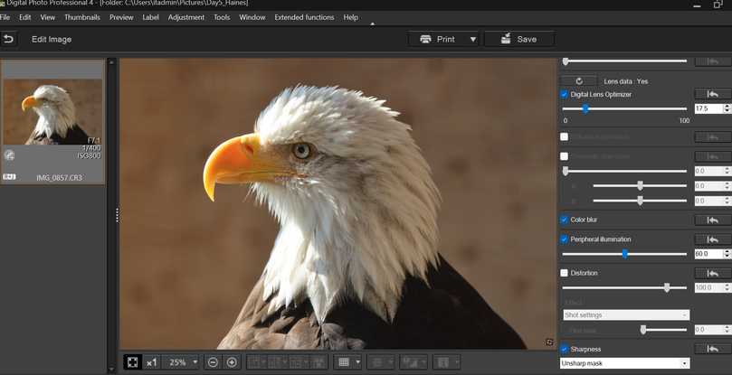

You have received good information from others here about what DPI means. I am guessing you need to work around the ideas of the marketing site and not do not need to educate the marketing site.
I guess that a clueless marketing site might find it easy to have a computer program look at the image resolution values in the photo meta data. My Canon camera always puts a value of 72 DPI into both the RAW and JPEG files. If I edit the photo with Canon DPP free to download software, then DPP changes that value from 72 to 350. It might be that the only edits one would want to do are to crop, white balance, and digital lens optimizer, but the value would still change from 72 to 350 when a photo is saved. So, an easy way to change this value is to edit the photo, JPG or CR2, in the Canon DPP program and save it.
The free software exiftool program will display or change the value in the metadata. Changing the DPI value will not change the image, but in ancient times it would have changed how some web browsers displayed the image and how some programs printed it. https://exiftool.org/
