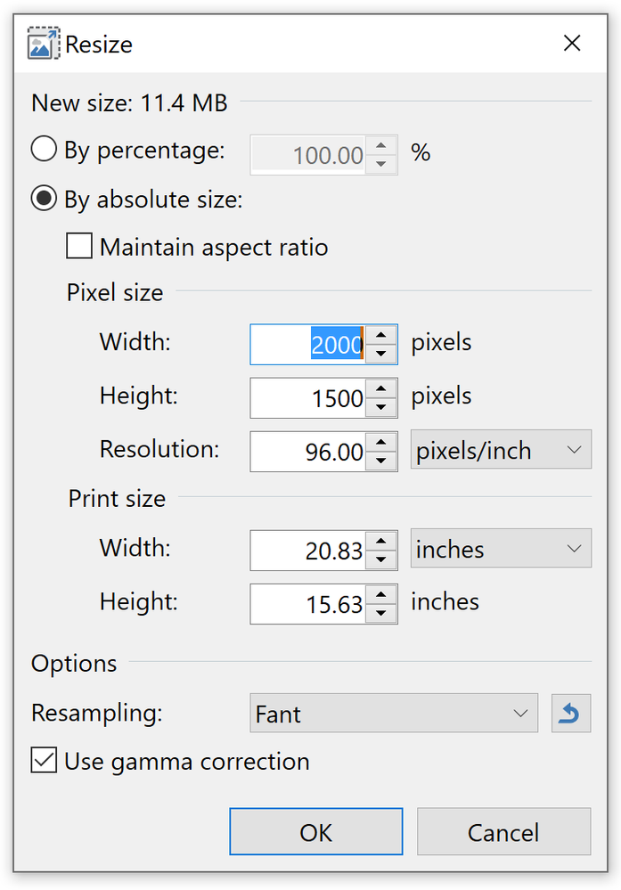

I agree with Ricky. They should also define an absolute image size, defined either in pixels or in/mm.. But an overall size specification is independent of a DPI specification.
If you are using a Windows laptop or PC, I suggest downloading Paint Dot Net to adjust the size of JPEG files. You can upsize or downsize canvas size, image size, and DPI or PPI. I do not know if this easy to use app has ever been ported to MacOS.
Paint Dot Net is easy to learn image editor. It is a good introduction to how advanced imaged editors function. It is far more advanced than MS Paint. But nowhere near as complex as GIMP or Photoshop. It is an image editor, not a photo processor.
09-09-2023 11:57 AM
This is what "Image Resize" dialog box looks like in Paint Dot Net.
Thre is a siimilar dialog box for "Canvas Resize".
