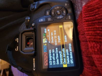

@ciderhouse_ wrote:
Yes it needs to clean the sensor cause there are spots on my pictures
Again.  What are you doing to the camera?

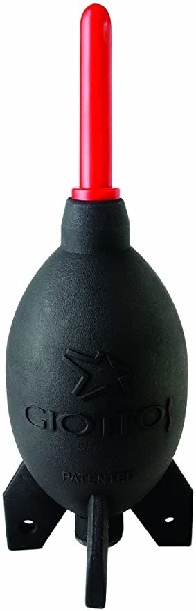

What method(s) and cleaning tools are you using to clean the sensor?  If you see spots on your images, then the only tool you should need would be an air blower, similar to this one.

It shows when I look through the eye of the viewer and the lens. The pictures have marks on them
Ok if the images you have taken have marks I strongly recommend taking in for a professional clean. Many camera stores can arrange that. Doing it yourself can land you in a lot of trouble.
cheers, TREVOR
