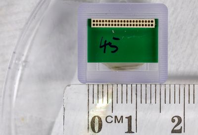

If we go for lenses that are not specifically macro, then there is a lot more choice: For example, I used the RF 24-105 L f/4 to photograph minute circuits used in lab experiments using this lens and it did a great job, in available light, hand-held, as an example of the story involve:
The researchers were doing this using powerful microscopes:
EOS R5, RF24-105f/4@40mm, f/4, 1/40sec, ISO-500EOS R5, RF24-105f/4@40mm, f/4, 1/40sec, ISO-500 The actual circuit boardThe actual circuit boardInjecting layers of polymer for protectionInjecting layers of polymer for protection Checking the circuit on a testerChecking the circuit on a tester
Considering this is a general-purpose lens that could also do your forensic work, it's a great and flexible workhorse. Being built for pro use it will take punishment of a news agency.
