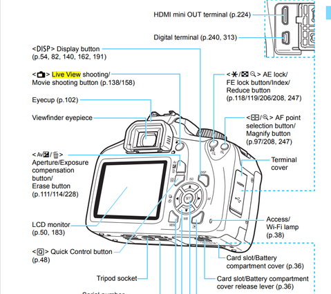

OK that makes sense.  You have the Live View feature turned on, which causes the camera to raise the mirror up and block the viewfinder.  You need to turn off Live View and then the mirror will flip down.
See the User Manual: eos-rebelt100-3000d-im1-en.pdf (c-wss.com)
The button that controls this is shown on P27.
cheers, TREVOR
Is there a way to have both on?
