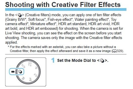

That looks like some type of Creative Filter, to me.  What shooting mode are you using on the top dial?
Do you know how to turn off Creative Filters?  Resetting the camera back to factory defaults should clear it.  You would first need to turn the top dial to “P”, and then look for the reset/restore option in the menus.
It is the creative filter mode, I have not seen this on any other camera:
