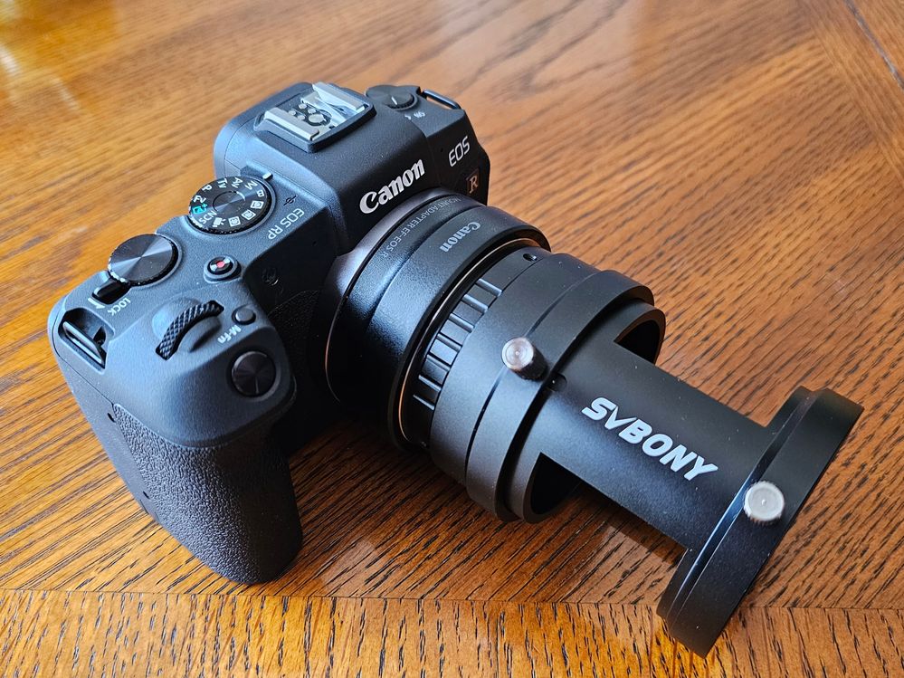

I purchased an EOS RP camera recently. The settings have the sensor cleaner enabled on shutdown. I don't use the camera specifically with a lens, but use both a t-ring adapter for the R mount and also the Canon EF-EOS R adapter to connect to a spotting scope. Quite frequently the sensor cleaning initiates spontaneously, usually when the body of the RP is shaking a bit or unsteady (as in adjusting the focus while on a tripod). Is this normal behaviour?  Should I disable that setting and just clean it manually when I shut it down?

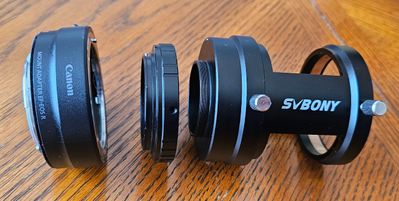

I think I mentioned that I had the same result with a Canon EOS R to EF adapter connected to a t-ring for EF and then to a SVBONY adapter to a spotting scope. Sorry, I didn't include that picture so here it is.

I tried (1) the Canon EFS to R adapter and t-ring and (2) the EFS to R adapter alone with cap on it, in both cases attached to the RP. After a fair amount of trying I couldn't get a random sensor-cleaning trigger. But when I connect the entire assembly to the scope body I get occasional random sensor-trigger triggers. I disabled the sensor cleaner and it doesn't appear to happen.

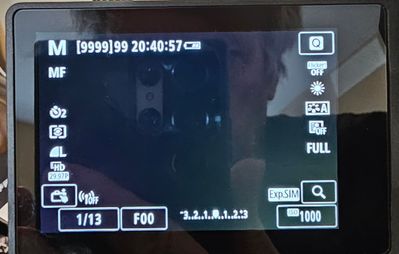

I use the RP in manual mode and settings are as below.
