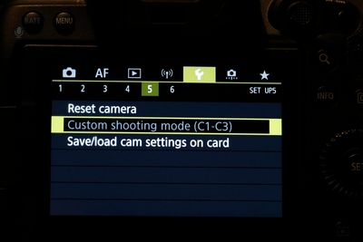

However, I think what the OP is seeking is not HDR, but AEB which can be customized, and saved to a C1 or C2 setting - I just did it on my R5 and it should work on the R8.  The intention of the two would be similar, but AEB gives much more control over the process, from what I can see.
So, can I suggest that you go to the red tab, 2nd page and  turn off HDR if you have it set, and go up the menu in the same screen to configure and customize the settings for exposure/AEB and make the changes within that which you want to configure.
Then go to the Wrench screen, Page 5 and Save the current configuration to C1 or C2.  If you don't want auto updating (best not at first) then make sure that option is off.

Trevor, this is what I get regardless of which way I approach it. These shots are from the R5, but it's the same on all of the R's I own (I just tested all to be sure). Not sure if it's a difference in f/w in the U.S. or what, but mine will not allow HDR to be assigned to C functions.
It's grayed out with HDR enabled.

If you select it, this is the message. 
