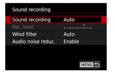

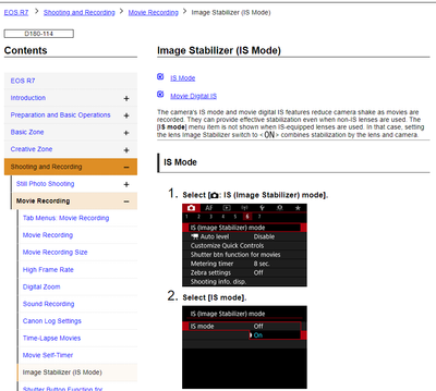

I pulled those examples of the sound and digital IS off the top of my head based on the differences the student had presented to me. To expound a bit more on those specifically, I've include a couple of screenshots from the online manual with explanations for each:
In the example above from the online manual, the student has stated that he only has the option to turn the audio recording "on or off." No additional features shown like the wind filter or audio noise reduction, and not an option for "Auto" sound recording.

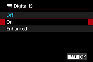

For the next example (Digital IS) the student does not have the option at all, where as in the manual it has the option for On/Off/Enhance. Essentially, the student does not have this menu.

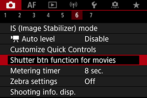

Also of note is that while in movie mode (on/off switched to "movie") the menu on the student's camera only shows 4 top options (numerically) when viewing the first list and the manual shows 7, and when in still shooting mode the student has only 6 options numerically where the manual shows 10...if that's not enough of a word salad already, let me just say that in the example below the numbers at the top of the student's camera only go to 4, not 7, and there are no icons past the wrench.

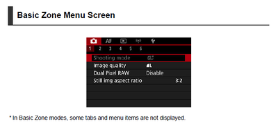

I haven't confirmed it with my student yet but it is highly possible that the mode dial was the issue. It appears that only certain menus are available when in Basic modes. Once I've heard back from the student I'll let you know.
-Adam
That is absolutely true.  The menus for M, AV and TV are far more extensive than those for the more automatic ones - see the manual on P85.
cheers, TREVOR
