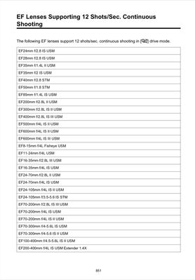

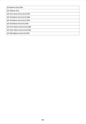

According to this page by Canon there are many EF and EF-S lenses capable of 30fps(including 18-135 USM and STM) so I don't see the need to advise(at least for this problem) buying RF lenses.”
That entire section of online documentation is poorly written.  It conflates the shutter modes and frame rates. It should only apply to the default shutter mode.  This screenshot is from the User Guide for the R5.
