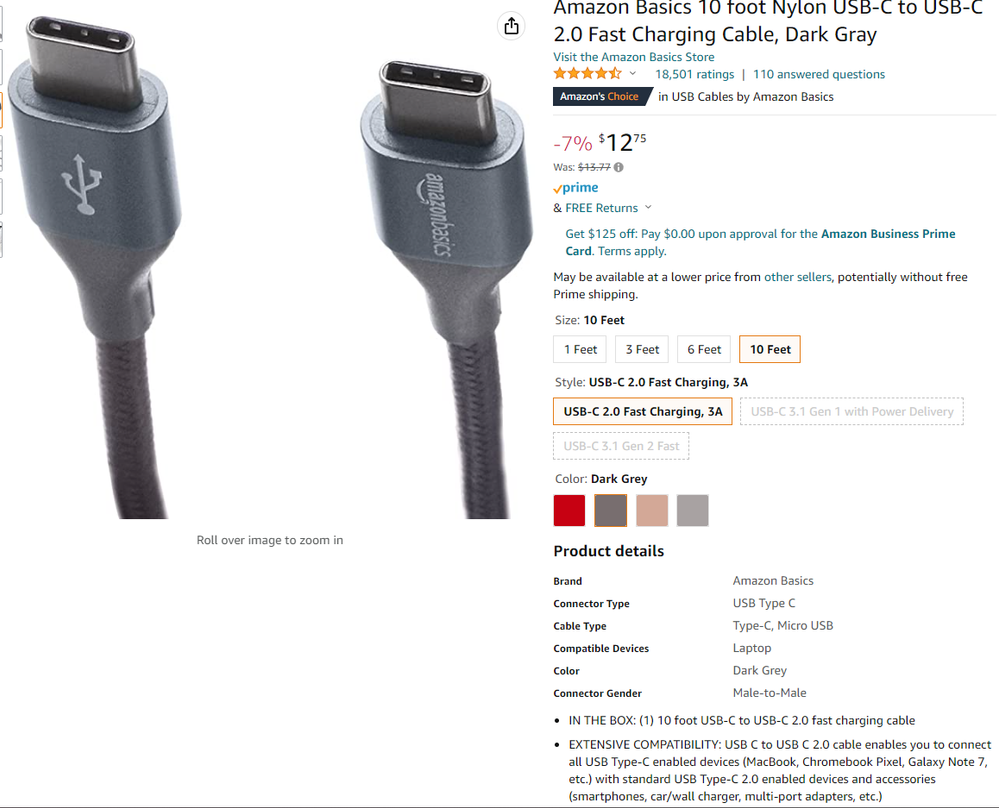

Thanks so much! MacBook Air the 2020 M1 and its on Monterey 12.5.1. I haven't downloaded software yet for it though. Ideally I would use Lightroom. I'm doing food photography and want to be tethered to my Mac. Thanks for the call out on the USB port adapter. I do have one of those but I won't use it for this purpose.
Do you think this would work?
[Removed link per forum guidelines - replaced with screenshot]

09-05-2022 08:01 PM - edited 09-05-2022 08:10 PM
Canon : Compatible Accessories : Cables (start.canon)
The Canon IFC-100U is pricey.
A generic USB 3.1 Gen 2 from Amazon should work. You want a data cable, not just a charging cable.

That cable would not work because it is charging cable, which means it lacks a sufficient number of wire conductors to transmit data. You need a data cable.
