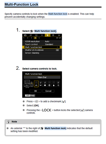

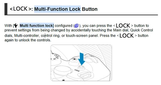

Also, check the position of the [LOCK] switch.  There are camera settings that can disable those touch control and other buttons.

Have you checked that the Multi Function Lock switch is not enabled?  The lock switch does what it says.  It locks the controls of your camera.  If you are feeling for the shutter or video record buttons, it is quite easy to enable that by mistake.
You can use the menu to configure what that switch will or will not do.
