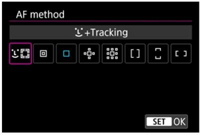

No, for BIF, if I set Face+Tr in my R5's FP selection group and select "Animal" as the subject, it has the same effect as Whole Area in the R6 II and picks up my birds faces, no matter where they are on the sensor. If at a great distance, it will just put a box around the entire bird. I only use it for BIF and it basically allows for slop that I get from my bad initial aim 🙂
This is the way AF method selection looks in the R5. I have this bound to my lens control ring with some of the selections disabled.

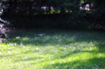

This is a FF that shows how Face+Tr actually picked up an insect face (dragonfly) from about 60 feet.

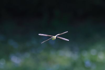

Cropped.
