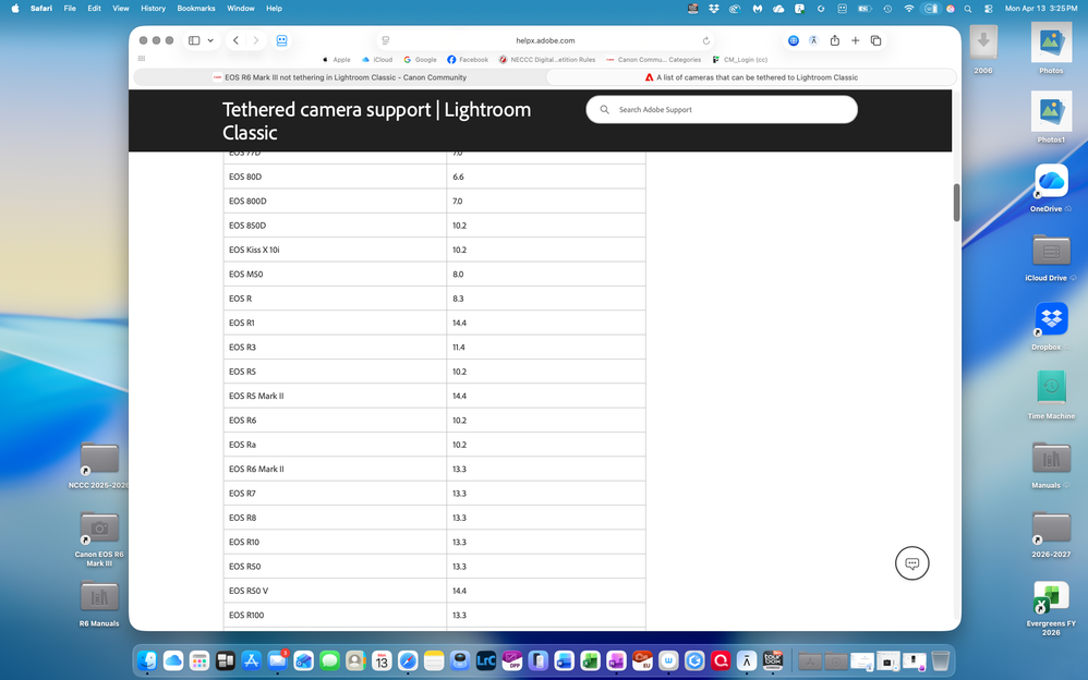

@Aatj wrote:
I am also having trouble shooting tethered with my brand-new Canon R6 Mark III.
Lightroom is up to date 15.2.1, my computer runs OS Tahoe 26.3.1, and it just won't work!
The cable is also new and 2 meters long. Who can help me?
Going to the source:
04-13-2026 09:53 PM
When I reported that my Belkin cables did not work, I was referring to the EOS Utility. I use LR for post processing. The Canon software is what I use for remote controlled shooting.

R6M3 not yet supported by LrC. Not a cable or camera setting issue.

JRH, I don't have a R 6 Mk III to try but I suspect if you have the correct cable (as pointed out by others) it will tether to LR v15. The problem is the handling of the R6 Mk III's CR3 file may not be accurate.
It should be easy to see if Windows sees the R6 Mk III in File Explorer or whatever the Mac equivalent is.. If Windows can see it, so should LR. BTW, the list you offered is not always right up to date. I've been dealing with Adobe far too long to not realize that.
