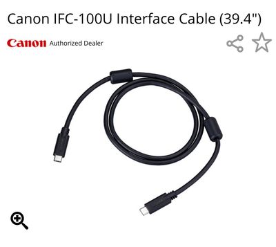

Hoe long is your cable? The standard cable is only 1.0 meters long. It also has baluns to reduce RF interference.  Cables without them probably won’t work.

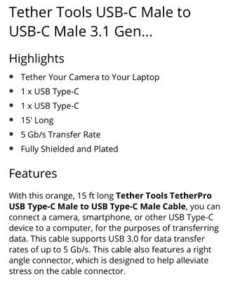

This is my cable https://www.bhphotovideo.com/c/product/1619202-REG/tether_tools_cuc15rt_org_tetherpro_usb_c_to_usb_c...
B and H said to buy this one. It's the same that I use for my 5D Mark IV. I could never shoot with a 2 m cable, not enough slack for me.

The R6 Mark III Canon manual at https://cam.start.canon/en/C022/manual/html/UG-11_Reference_0090.html specifies a higher-speed cable than the one in your B&H link.  It calls out "Equivalent to USB 10 Gbps (SuperSpeed Plus USB / USB 3.2 Gen 2)" versus the lower-speed 5Gbps cable from B&H.  I suggest you find a short compatible full high-quality high-speed USB-C cable and verify functionality with that cable and then find out if you can obtain a longer cable that meets the the Canon speed specifications as outlined in the manual.

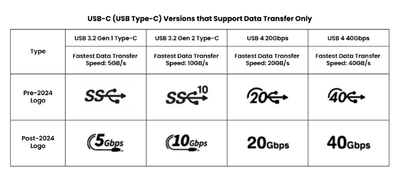

The USB-C specification in the R6 Mark III appears to be the latest and highest quality USB-C available and you'll need to get the right cable to support it.  For some time now charging a Canon camera has not worked over USB-A to USB-C cables and more and more devices are moving to the newer and faster standards.  I took the chart below from benq.com, who sell projectors, monitors, etc.  It doesn't take much work to find out there are a significant number of USB-C cable options.  This is also true of HDMI, of course.  The Canon manual implies you'll need a USB 3.2 Gen 2 Type-C, and a cable sustaining that for the distance you want, which may imply you might be better off with a USB-4 cable.
I will note that a quick search of cables shows many online cables showing 3.2 capability and compatibility, but that does not imply true native 3.2 Gen-2 Type C certification.

I suspect that this is a cabling problem. The B&H cable at the link is 25 feet long and is rated at 6 gigabits.  It also lacks baluns, which are essential with the camera.
Has the connection been tested with the Canon cable that came with the camera?

I had bought (2) 3 meter cables.  Neither cable worked. But the cable that came with the camera worked fine.
