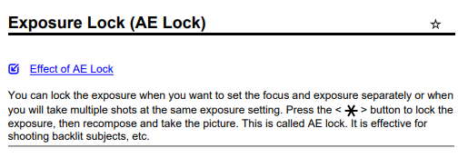

This is from the R6 Mark II manual:
And from page 212 of the same manual:
Although here it is not clear if "compose the shot" means depress the shutter button half-way.

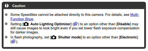

And more of an FYI - I just discovered this in the manual and changed the 2 settings from the defaults to the recommended settings for flash photography.  Prior to this change, pics with the flash on were very bright and ISO (automatic) was very high.  Now things look great with the flash.
