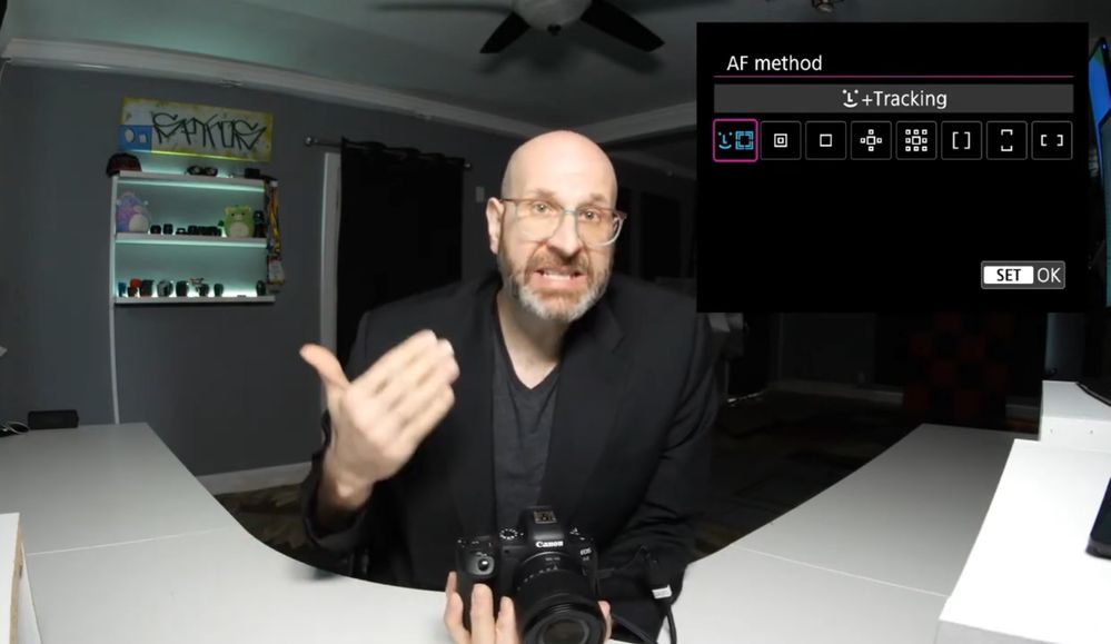

AF points can have one of two modes, enabled or disabled. You select which AF points are enabled or disabled. This selection method can be seen at the 1:10 mark in the video.
Let’s review the AF point selection modes. Sometimes it helps to hear it explained differently. The AF system will only look at the scene using these modes. Let’s start from the left and move across to the right.
He makes one confusing statement here when he says “One Shot” is what you should be using most of the time. One Shot does not track subjects. Once the AF system locks focus after you half-press the shutter button, the AF system pauses until you fire the shutter or release the shutter button.
The first selection on the far left is “face detection + tracking”, which is a fully automatic AF mode. It is comparable to, and used by, the Green Square shooting mode on the top dial.
When you select a single AF point, Spot AF or 1-point AF, these are the only AF points that are enabled. Every other AF point is disabled. The task of tracking a subject falls solely on the photographer, who must keep that single AF point on the subject.
The next two selection modes are “Expand AF” and “Expand AF Surround”. These modes work like the 1=point AF mode, but with the addition of either 4 or 8 “AF Assist” points. The main AF point is in the center. The photographer is still solely responsible for tracking the subject’s movement, except you now have some help. If your main AF point slips off the subject, then one or more of the AF assist points will maintain focus on the subject until you can re-acquire the subject with your main AF point in the center of the cluster.
The last three AF point selection modes enabled a large zone of AF points. You must select one of these Zone AF modes, which have different shapes, to enable the advanced tracking features in the camera. The photographer is still solely responsible for tracking the subject’s movement, except you now have some additional, intelligent help.
The photographer is somewhat relieved of the responsibility of keep a single AF point on the subject. The photographer is now responsible for keeping the large AF zone on the subject. The AF system behavior is determined by the other settings, such as eye detection.
