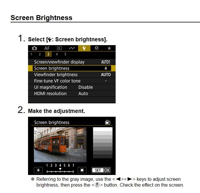

You can't judge an image using the LCD since the brightness of the LCD is adjustable.
If you are using Manual mode you would set the exposure by looking at the exposure scale.

I'm having a little difficulty understanding your problem. Do you mean that the display on your LCD screen is darker than your final picture? One thing you can do is increase the brightness of your display screen.
