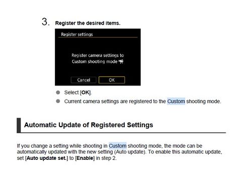

Use the custom shooting mode C mode to register your settings and allow recalling them when you turn on the camera. See the manual.

10-17-2023 02:02 PM
Thank you for the reply!
Yes, that worked! For some reason I didnt't get that those are related things, so Thank you!)
