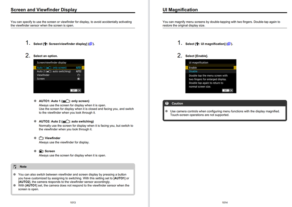

I know that the viewfinder doesn't work if the screen is open so I mostly shot with the screen.
That's not correct, depends on the settings you make here:
