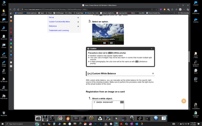

Here's what the Canon manual says for the R6 Mark II. May be also true for R5.
John Hoffman
