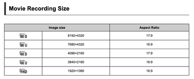

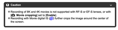

For the EOS R5, the answers are in the manual. If using an EF-S or RF-S lens, then some record formats will not be available. When using an EF lens with a Canon adapter, then all are available. Storage media speed may make some of the highest data rate recording formats unavailable, so it may be necessary to purchase a faster memory card. The manual lists what video formats are supported for the various card speeds.
https://cam.start.canon/hy/C003/manual/html/UG-03_Shooting-2_0040.html
