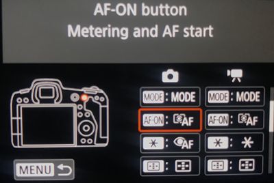

First time I noticed this when I was trying to shoot an egret in a flock, when the next to it started fighting with a 3rd one. They all were in same frame. I wanted to switch the Eye AF quickly to the second one in the frame by moving the joystick and placing the AF point on second one and then pressing  'AF-ON' and '*' buttons .
'AF-ON' button did metering and focusing on 2nd egret's head. But as soon as I pressed '*' button, it returned to the first egret's eye instead of locking into second egret's eye. Since they were in different focal planes, I think, R5 did not provide the "white-arrowed-square" switching option. Eventually, ended up taking the shot while holding the 'AF-ON' button and got the whole egret head in the blue box.

  4. Tried all metering modes.
  5. AF mode : tried 1-Point, Spot AF

First time I noticed this when I was trying to shoot an egret in a flock, when the next to it started fighting with a 3rd one. They all were in same frame. I wanted to switch the Eye AF quickly to the second one in the frame by moving the joystick and then pressing 'AF-ON' (customized to Metering and AF Start) and '*' button (customized to Eye AF). 'AF-ON' button did metering and focusing on 2nd egret's head. But as soon as I pressed '*' button, it returned to the first egret's eye instead of locking into second egret's eye. Since they were in different focal planes, I think, R5 did not provide the "white-arrowed-square" switching option. Eventually, ended up taking the shot while holding the 'AF-ON' button and got the whole egret head in the blue box.

  3. Using back-button focus and Eye AF assigned to another button.
