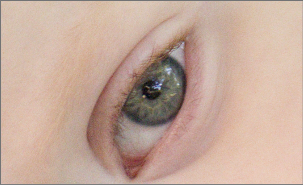

Seems normal to me. Cropped 200%.
Skärmbild från 2024-01-24 14-05-48.pngSkärmbild från 2024-01-24 14-05-48.png
Your second raw file seems to have front focus. The hat and the chest are in focus.
Your third raw file also. The hair to the left of the eye are in focus.
All three raw files seem normal, noise wise. Your print screens on the other hand I see a lot of noise created from color NR and sharpening in post.

I agree - it looks much better in your pictures. So, I must be doing something wrong in post? The eye looks a lot worse in my zoomed in example (see the dropbox folder). Any idea what I might be doing wrong for it to be so grainy? Most of my pictures look grainy in Lightroom, even before I edit them. So I'm not sure it's a setting or a filter-thing.
Sharpening non-details.

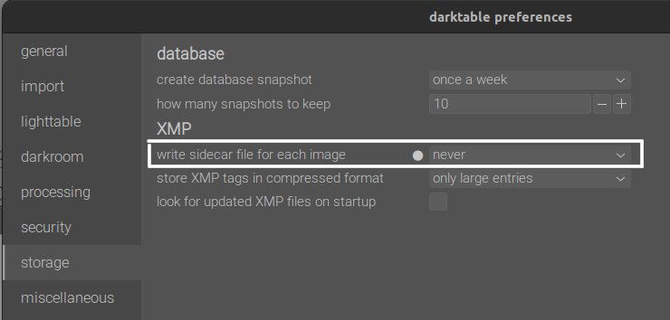

If you want to check how your raw files look like with minimal editing you can load your raw files in darktable. It doens't mean that you should edit your raw files in darktable but it may help you to see:
  • how good you nailed the exposure without hidden tone curves
  • what your raw files look like without any NR and sharpening
  • you get a way to inspect raw clipping in the highlights
Turn off everything that will brighten the image.
I would turn off this one also so that you don't get a lot of XMP files in your folders.
