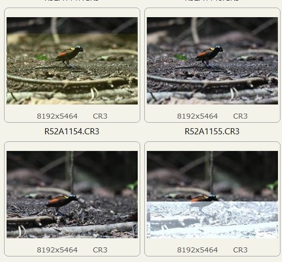

Hi,
Any R5M2 owner encountered a "layer" of additional/missing colour platter in your photo taken?

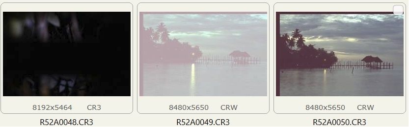

Initially, I encounter image preview issue where the camara states that the "current image cannot be previewed" on the camera but didn't thought much about as it was already night and I'm shooting the cuscus near the homestay. But things took a turn the next day when I'm shooting the bird of paradise. A quick preview on some of the images show symptom the night before and worst, photos with additional/missing colour platter.
As I continue to review the images, I noticed some of the images either have a tinge of colour, e.g. green, yellow, pink etc., either in in full or partial on the images.
Initially, I thought it could be due to the slower SanDisk UHS 2 SD card wasn't able to catch-up with the write speed that causes the problem. So, I removed the SD card and let the camera write to the faster Prograde CFExpress card with the sustainable write speed of 1300MB/s.
However, the issue persisted and even more ridiculous! I took the camera for a sunrise shoot one morning, instantly, the 1st shot encountered the problem describe above on the CFExpress card. Therefore, the theory of incapable card or heating is ruled out.
Would like to hear from follow R5M2 owner if you've encountered such issues.

Firmware v1.01 // Highlight tone priority D+2 on shooting the bird, and was disabled when shooting sunrise // Elec shutter for BOP @ H+ and Mech shutter for sunrise at single // SanDisk 256GB Extreme PRO SDXC UHS-II Memory Card with R=280MB, W=150MB // ProGrade Digital 1TB CFexpress Type B Memory Card (GOLD) with R=1700MB, R=1300MB
Thanks.
